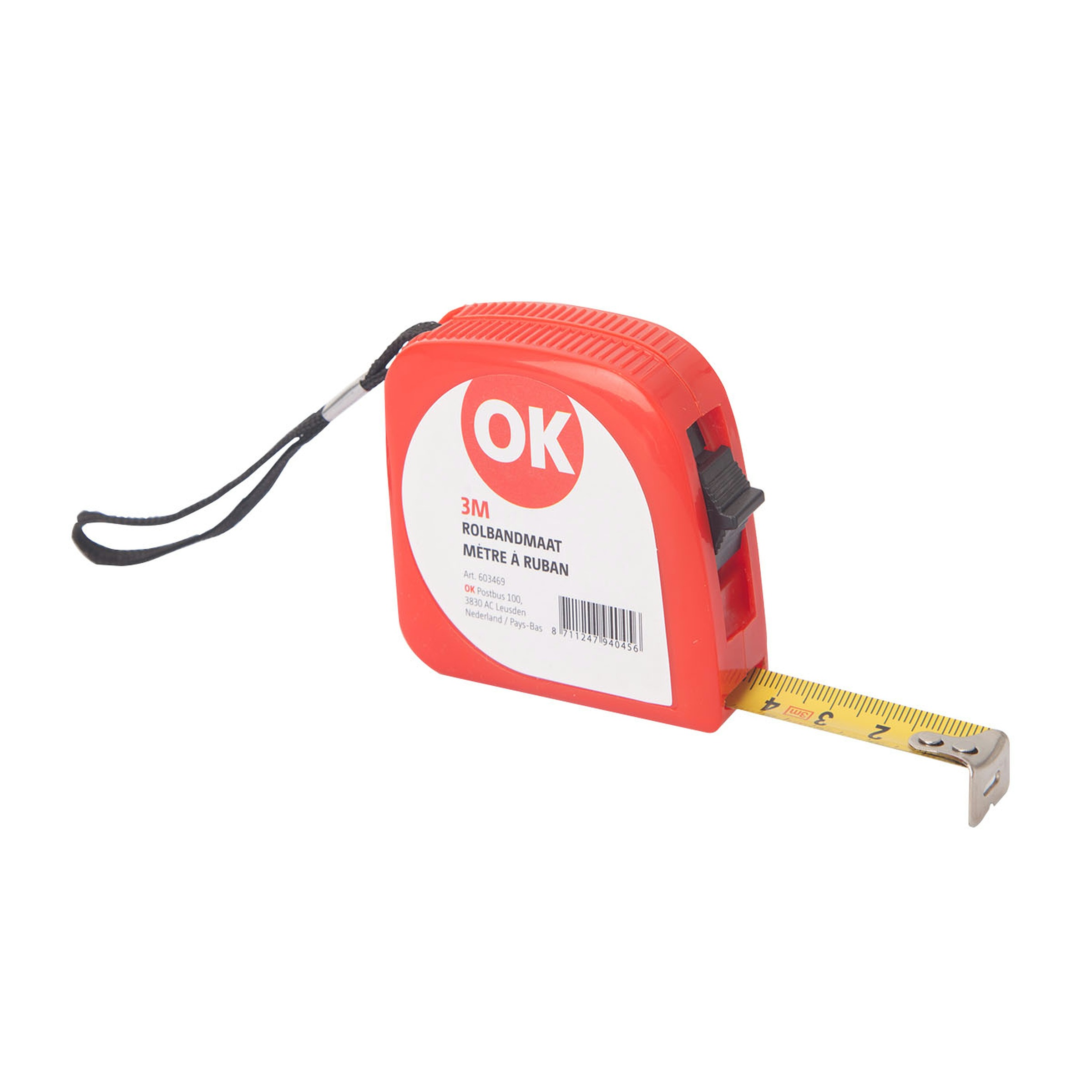

Chain checker:
I can't speak Dutch, I'm using Google translate.
